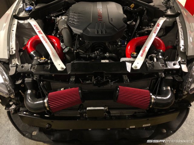

SSR Performance Cold Air Intake - $769.00 USD, Part# NA
www.ssrperformance.com
