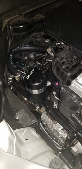

I have installed the ADD w1 can on the PVC side. I used the 2 port can and may be adding a separate check valve. Not sure what I am going to do if anything on the breather side. I didn't care for the big angle bracket that came with the Stinger kit to mount to the wheel well studs so I fabbed a bracket to bolt up to the manifold bracket using the small tab bracket that comes with the OCC. 20190525_162520.jpg 20190525_162451.jpg
