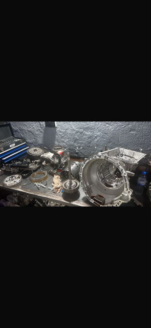

The transmission was removed and completely disassembled. To remove and reinstall the transmission, the engine was also removed.
The clutches/friction plates, solenoids, transmission fluid and filter were replaced, and the torque converter was repaired. The transmission was then reassembled, installed and calibrated.

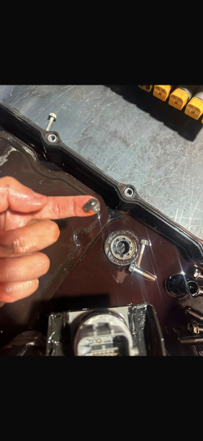

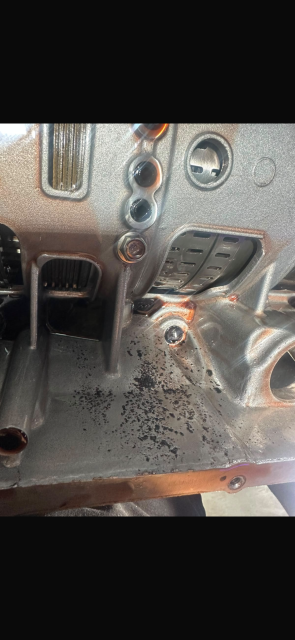

The car worked normally for about 4 days. Then, after approximately 100 km of normal highway driving, the problem returned — the transmission started slipping and had problems transferring power again.
The transmission was disassembled again. They have now found that one of the clutch/friction packs is damaged again. It is currently being replaced and the transmission is being reassembled.
What could cause a clutch/friction pack to fail again almost immediately after a transmission repair? Any ideas?
