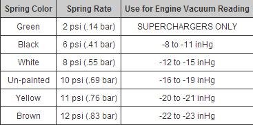

Black, do you have the colors/list?
Thread Starter #42
Your good chris71, black is the color it should be.

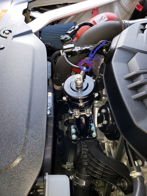

To bypass ecu do i attach bov line here?
Thread Starter #50
No It attaches to your Injen intake, the one you plugged on both side of your intake pipe.

I meant where can I connect to bypass solenoid to test the tial? Ignore my d. Valves.
Thread Starter #52
I don't believe you can bypass the solenoid, it has to be plugged in to work right. There was another guy on here that broke off the nipple where that nose slides onto and he had to buy another one. He ask if he could bypass or just not use it an Rob the other Moderater said no, you can drive it but it will drive like crap.

If the car didn’t have the solenoid and a computer modifying parameters if it sees something not working correctly, your BOV would connect to the intake manifold after the throttle plate.

To bypass the ECU you will need to T-in all three vacuum lines and completely remove the sensor. The car will run ok but I am unsure if removing the sensor completely will trigger a CEL or limp mode.
In my case I had the same problem (broken nipple at the sensor and drove like that for a while without knowing and without issue)

So what I'm reading is our cars have 6psi? Isn't that kinda low considering I often see 14 to 16 osi on other cars?
Thread Starter #59
I read in another forum the car has 12 to 13psi stock.
boost from the manifold holds the BOV in place under throttle. So you don't want a spring rated for your max boost otherwise your intake might not be able to push it up to vent.
