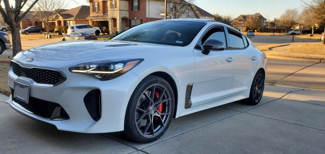

Went through Getyourwheels.com for these rims, and the sales rep, Jason Tung, was great and everything went smoothly and they were delivered in a timely manner.
The wheels are Stance SF07 Dual brushed gunmetal, 19x8.5 all around, with +35 mm offset, with Pirelli P Zero.
I tell you what, new rims really enhance the character of the car.
